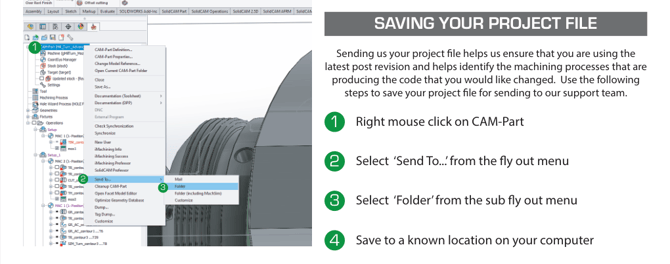

--certifications-- SolidCAM_SendTo
  1. Right-click on CAM-part in the SolidCAM / InventorCAM feature tree.
  2. Select 'Send To' near the bottom of the drop-down menu.
  3. Select 'Folder' from the second drop-down menu
  4. Save the file to a known, accessible location on your computer
  5. Attach this file to your support ticket

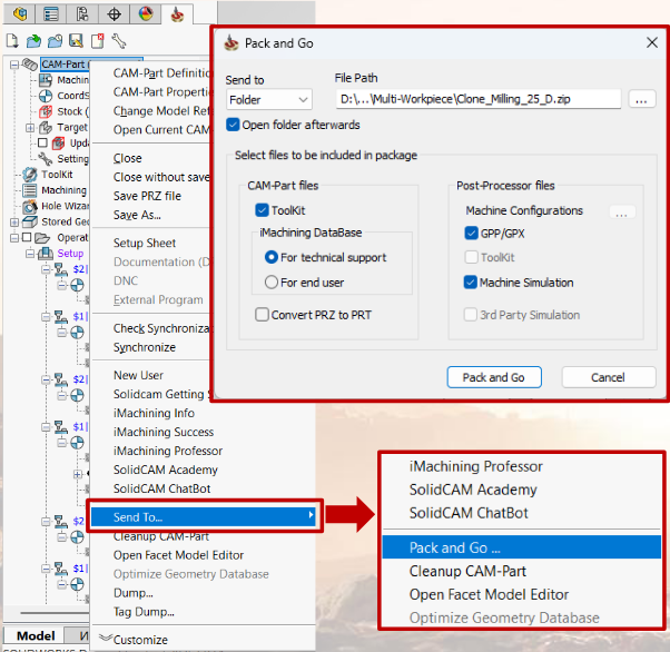

For SolidCAM 2026 and later:
  3. Select 'Pack and Go'
  4. For technical and post support, please click select the options shown in the above screenshot (these options should save for future use):
    1. Under CAM-Part files select: ToolKit and For technical support
    2. Under Post-Processor files select GPP/GPX and Machine Simulation
