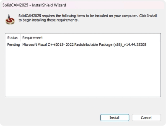

    Note: SolidCAM depends on the Microsoft Visual C++ Runtime libraries. If you're prompted, click Install to add the required Visual C++ Redistributable Package before continuing.

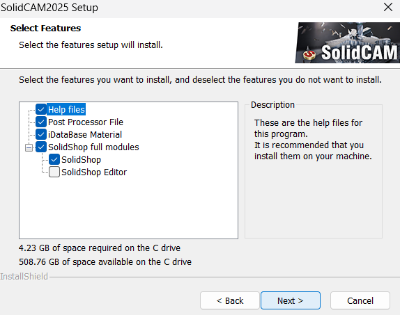

  8. Choose any additional features to install, then click Next.
    Tip: Enable SolidShop Editor if you want SolidCAM for Operators along with the SolidShop CIMCO modules.
