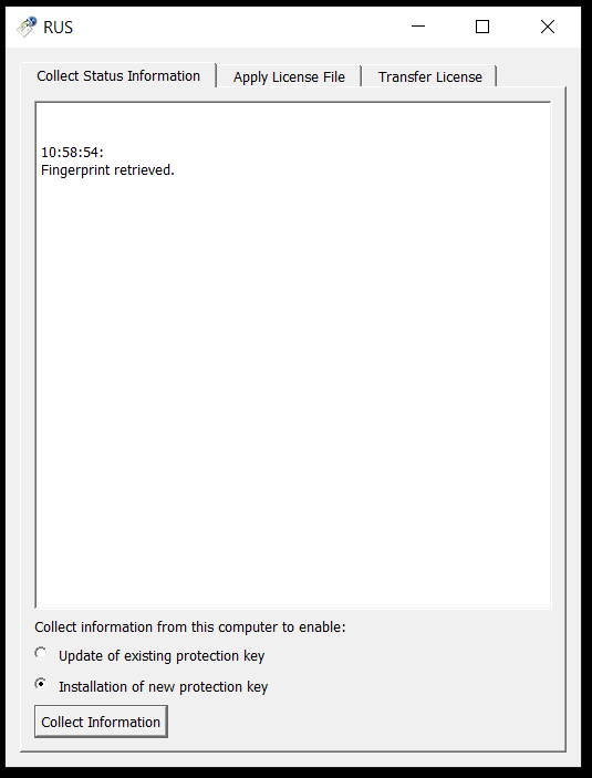

  1. Download the RUS_CADTECH.exe utility and run it.
  2. On the Collect Status Information tab, select Installation of a new protection key.
  3. Click Collect Information to generate a fingerprint.
  4. Click Save and store the C2V file somewhere you can find it again.
